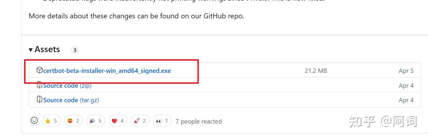

一、下载并安装软件
在这个网站下载最新的软件并安装https://github.com/certbot/certbot/
github下载certbot安装程序
下载完成后直接双击安装就行了
安装完成后,以管理员方式运行cmd,输入cretbot --version,如果有显示就说明安装成功了

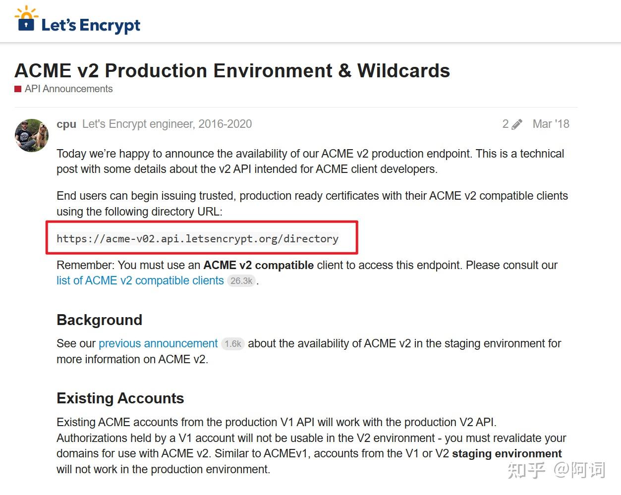

  • –server,Let’s Encrypt ACME v2 版本使用的服务器不同于 v1 版本,需要显示指定
官网里v2说明
*.example.top换成你想要申请的域名就可以了,接下来,会提示需要进行手动验证DNS:

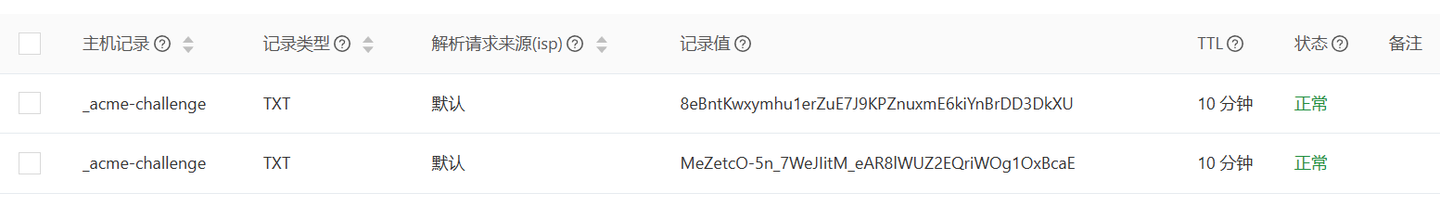

我的域名是阿里云申请的域名,去域名解析那手动添加一条TXT记录就可以了,我这里申请的是通配符域名,还有一级域名,就需要添加两条记录来验证
Please deploy a DNS TXT record under the name:
_acme-challenge.example.top.
with the following value:
8eBntKwxymhu1erZuE7J9KPZnuxmE6kiYnBrDD3DkXU
(This must be set up in addition to the previous challenges; do not remove,
replace, or undo the previous challenge tasks yet. Note that you might be
asked to create multiple distinct TXT records with the same name. This is
permitted by DNS standards.)
Before continuing, verify the TXT record has been deployed. Depending on the DNS
provider, this may take some time, from a few seconds to multiple minutes. You can
check if it has finished deploying with aid of online tools, such as the Google
Admin Toolbox: https://toolbox.googleapps.com/apps/dig/#TXT/_acme-challenge.example.top.
Look for one or more bolded line(s) below the line ';ANSWER'. It should show the
value(s) you've just added.
Press Enter to Continue
根据提示操作完成后,在域名解析那就有两条TXT记录了,如下:
