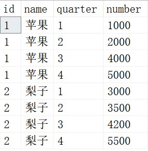

1、行转列的用法PIVOT
CREATEtabletest
(idint,namenvarchar(20),quarterint,numberint)
insertintotestvalues(1,N'苹果',1,1000)
insertintotestvalues(1,N'苹果',2,2000)
insertintotestvalues(1,N'苹果',3,4000)
insertintotestvalues(1,N'苹果',4,5000)
insertintotestvalues(2,N'梨子',1,3000)
insertintotestvalues(2,N'梨子',2,3500)
insertintotestvalues(2,N'梨子',3,4200)
insertintotestvalues(2,N'梨子',4,5500)
select * fromtest
结果:

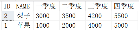

selectID,NAME,
[1as'一季度',
[2as'二季度',
[3as'三季度',
[4as'四季度'
from
test
pivot
sum(number)
forquarterin
([1],[2],[3],[4])
as pvt
结果:

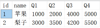

2、列转行的用法UNPIOVT
createtable test2
(idint,namevarchar(20), Q1 int, Q2 int, Q3 int, Q4 int)
insertinto test2 values(1,'苹果',1000,2000,4000,5000)
insertinto test2 values(2,'梨子',3000,3500,4200,5500)
select * from test2
(提示:可以左右滑动代码)
结果:

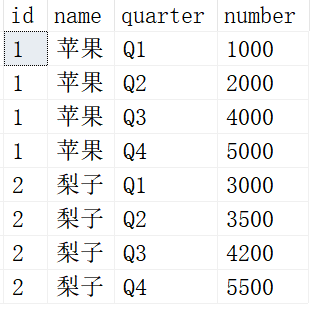

--列转行
selectid,name,quarter,number
from
test2
unpivot
number
forquarterin
([Q1],[Q2],[Q3],[Q4])
as unpvt
结果:

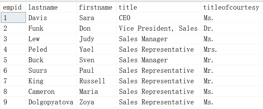

SELECT * FROM HR.Employees
结果:
select * from HR.Employees
where title in (
select title from HR.Employees
groupby title
havingcount(1)>1)
结果:
对比一下发现,ID为1,2的被过滤掉了,因为他们只有一条记录

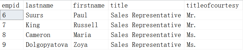

where title+titleofcourtesy in
(select title+titleofcourtesy
from HR.Employees
groupby title,titleofcourtesy
havingcount(1)>1)
结果:
title在和titleofcourtesy进行拼接后符合条件的就只有ID为6,7,8,9的了

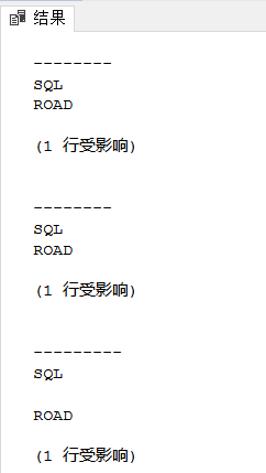

18、SQL换行
SQL的换行
制表符 CHAR(9)
换行符 CHAR(10)
回车 CHAR(13)
PRINT 'SQL'+CHAR(13)+'ROAD'
PRINT 'SQL'+CHAR(10)+'ROAD'
PRINT 'SQL'+CHAR(9)+'ROAD'
执行结果:
