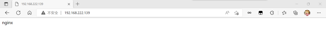

修改Web服务器的默认主页
Web1:
[root@Web1 ~]# yum -y install httpd   //下载服务
[root@Web1 ~]# systemctl stop firewalld.service  //关闭防火墙
[root@Web1 ~]# vim /etc/selinux/config
SELINUX=disabled
[root@Web1 ~]# setenforce 0
[root@Web1 ~]# systemctl disable --now firewalld.service
Removed /etc/systemd/system/multi-user.target.wants/firewalld.service.
Removed /etc/systemd/system/dbus-org.fedoraproject.FirewallD1.service.
[root@Web1 ~]# cd /var/www/html/
[root@Web1 html]# ls
[root@Web1 html]# echo "apache" > index.html  //编辑内容到网站里面
[root@Web1 html]# cat index.html
apache
[root@Web1 html]# systemctl enable --now httpd
Created symlink /etc/systemd/system/multi-user.target.wants/httpd.service → /usr/lib/systemd/system/httpd.service.
[root@Web1 html]# ss -antl
State      Recv-Q     Send-Q          Local Address:Port           Peer Address:Port     Process
LISTEN     01280.0.0.0:220.0.0.0:*
LISTEN     0128                      [::]:22                     [::]:*
LISTEN     0128                         *:80                        *:*
访问:

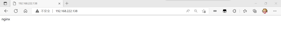

Web2:
[root@Web2 ~]# yum -y install nginx  //下载服务
[root@Web2 ~]# systemctl stop firewalld.service //关闭防火墙
[root@Web2 ~]# vim /etc/selinux/config
SELINUX=disabled
[root@Web2 ~]# setenforce 0
[root@Web2 ~]# systemctl disable --now firewalld.service
[root@Web2 ~]# cd /usr/share/nginx/html/
[root@Web2 html]# ls
[root@Web2 html]# echo "nginx" > index.html  //编辑内容到网站里面
[root@Web2 html]# cat index.html
nginx
[root@Web2 html]# systemctl enable --now nginx.service
Created symlink /etc/systemd/system/multi-user.target.wants/nginx.service → /usr/lib/systemd/system/nginx.service.
[root@Web2 html]# ss -antl
LISTEN     01280.0.0.0:1110.0.0.0:*
LISTEN     01280.0.0.0:800.0.0.0:*
LISTEN     032192.168.122.1:530.0.0.0:*
LISTEN     0128                      [::]:111                    [::]:*
LISTEN     0128                      [::]:80                     [::]:*
访问:

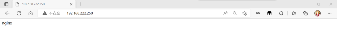

测试:
在浏览器输入nginx负载均衡器的IP地址

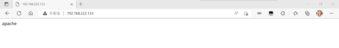

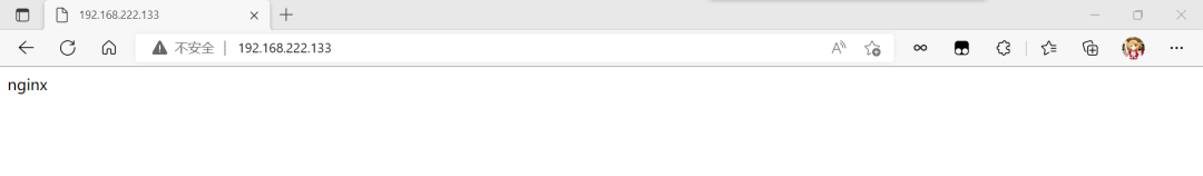

访问:
master:
[root@master keepalived]# curl 192.168.222.133
apache
nginx

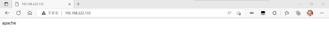

[root@backup keepalived]# curl 192.168.222.133
apache
nginx
访问:
可以看到,其中一个nginx负载均衡器挂掉了,也不会影响正常访问,这就是nginx负载均衡的高可用的配置

[root@backup~]# curl 192.168.222.133
apache
nginx
//备节点变成主机节点

[root@master]# curl 192.168.222.133
apache
nginx
//此时VIP重新回到master上面
